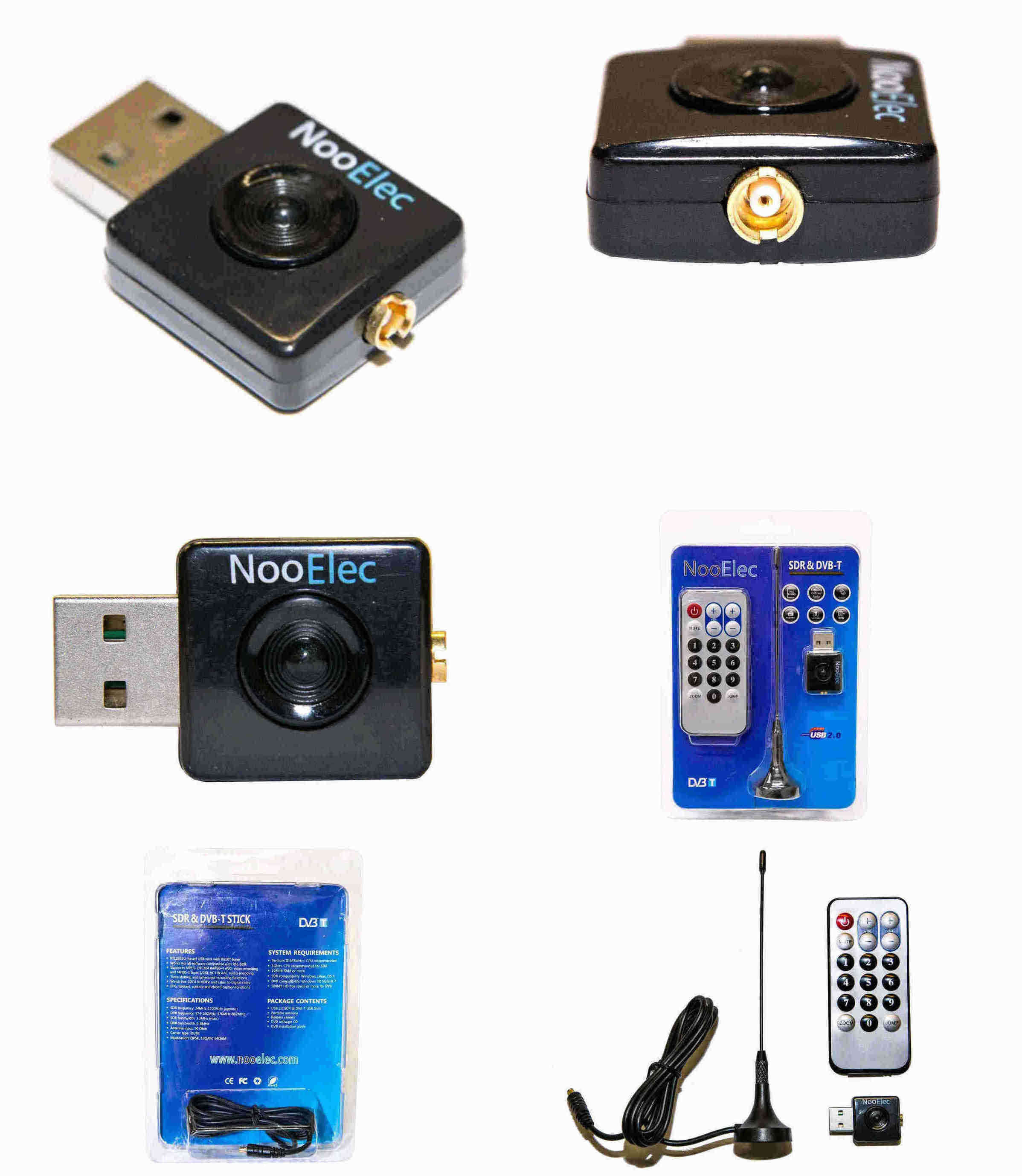

Suitable DVB-T dongles use the Realtek RTL2832U, DVB-T COFDM demodulator ic in conjunction with a suitable wide range tuner ic such as the Elonics E4000 or Rafael Micro R820T.
For this project, I am using the Nooelec NSDR Nano dongle which is available for $18 US including shipping. The Nooelec Nano uses the Rafael Micro R280T tuner which provides a tuning range of 25 - 1700 MHz. The Nano reportedly includes component upgrades designed to provide improved performance as compared to other generic DVB-T dongles.

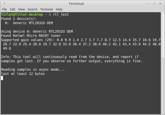

Installation Testing
To test your rtl-sdr installation execute the command rtl_test in the terminal. For a successful installation, the results should be:
If however, rtl_test returns something like "Kernel driver is active, or device is claimed by second instance of librtlsdr", your installation is using an existing kernel DVB driver instead of the correct driver installed with rtlsdr.
For a temporary fix, unload the incorrect driver using the command:
sudo modprobe -r dvb_usb_rtl28xxu.
For a permanent fix add the line
blacklist dvb_usb_rtl28xxu
to the file /etc/modprobe.d
