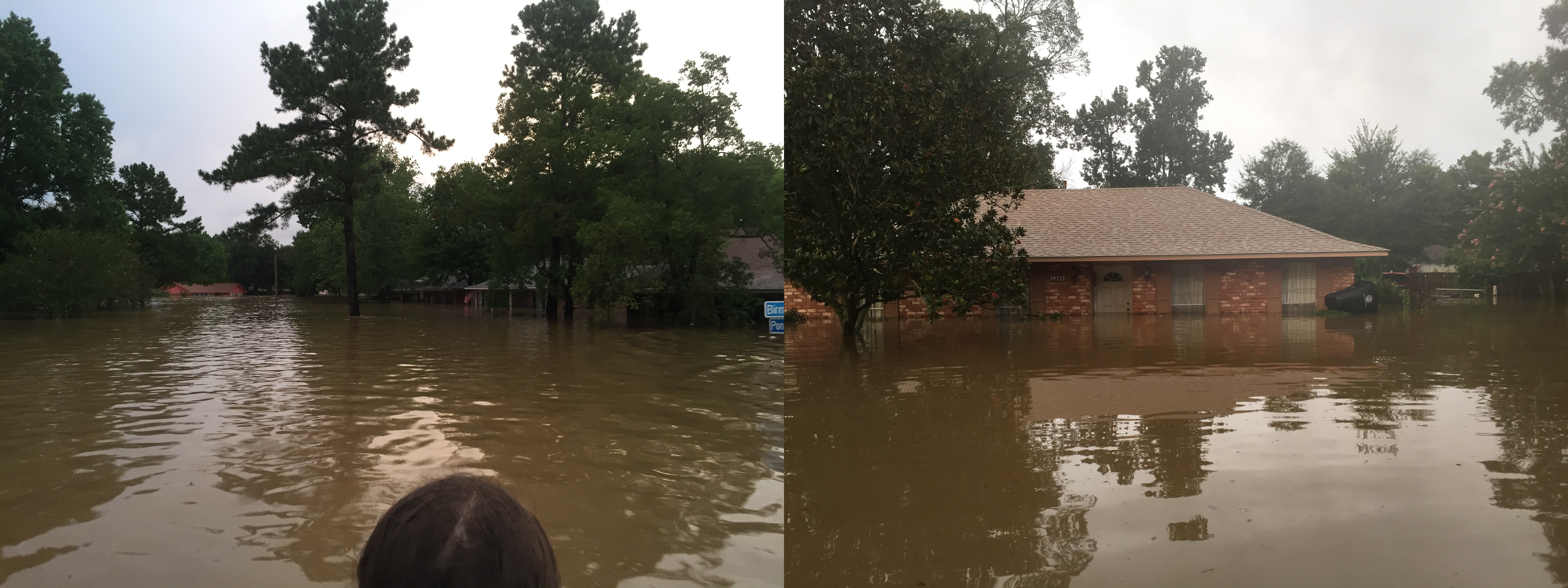

The Rain Event
Boating In To Rescue My Wife

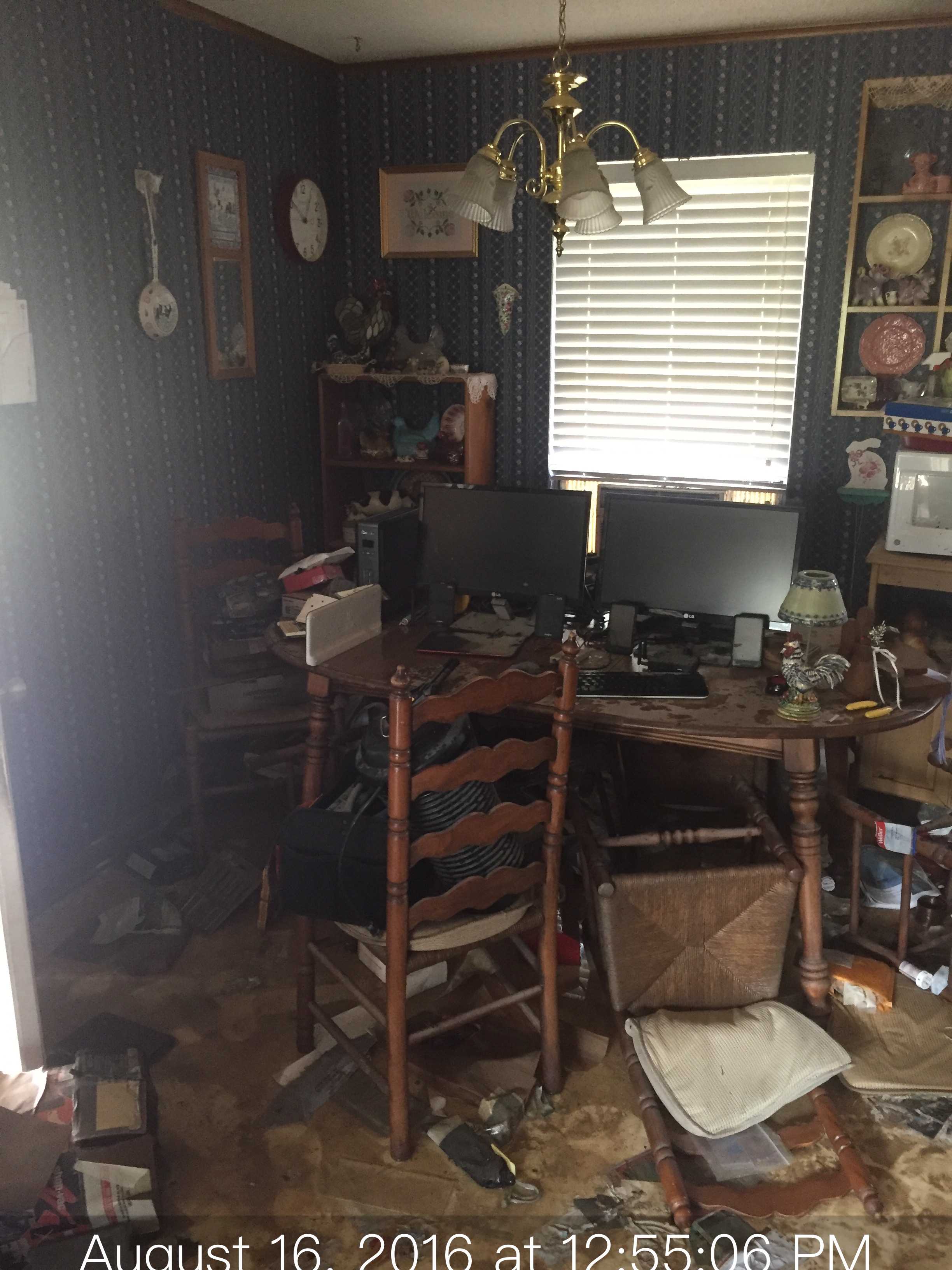

After The Water Receded - Fitlet Is On The Table

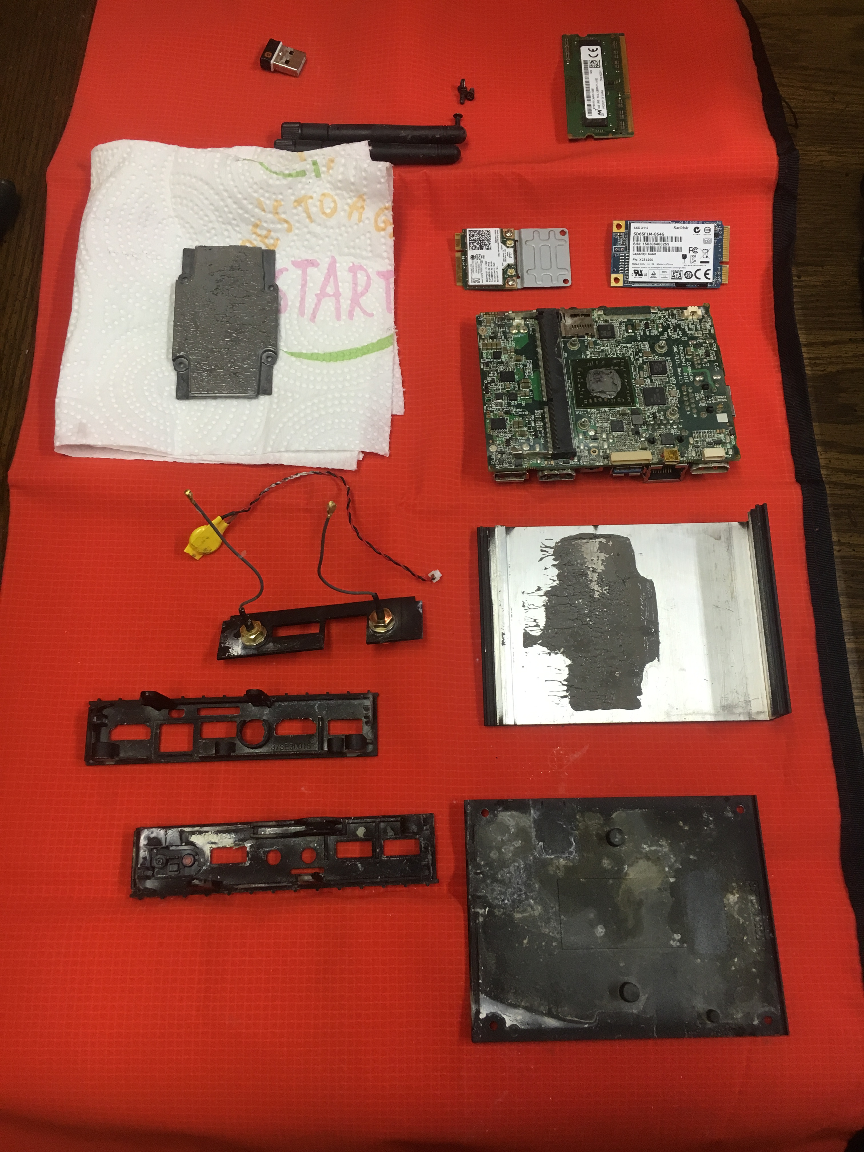

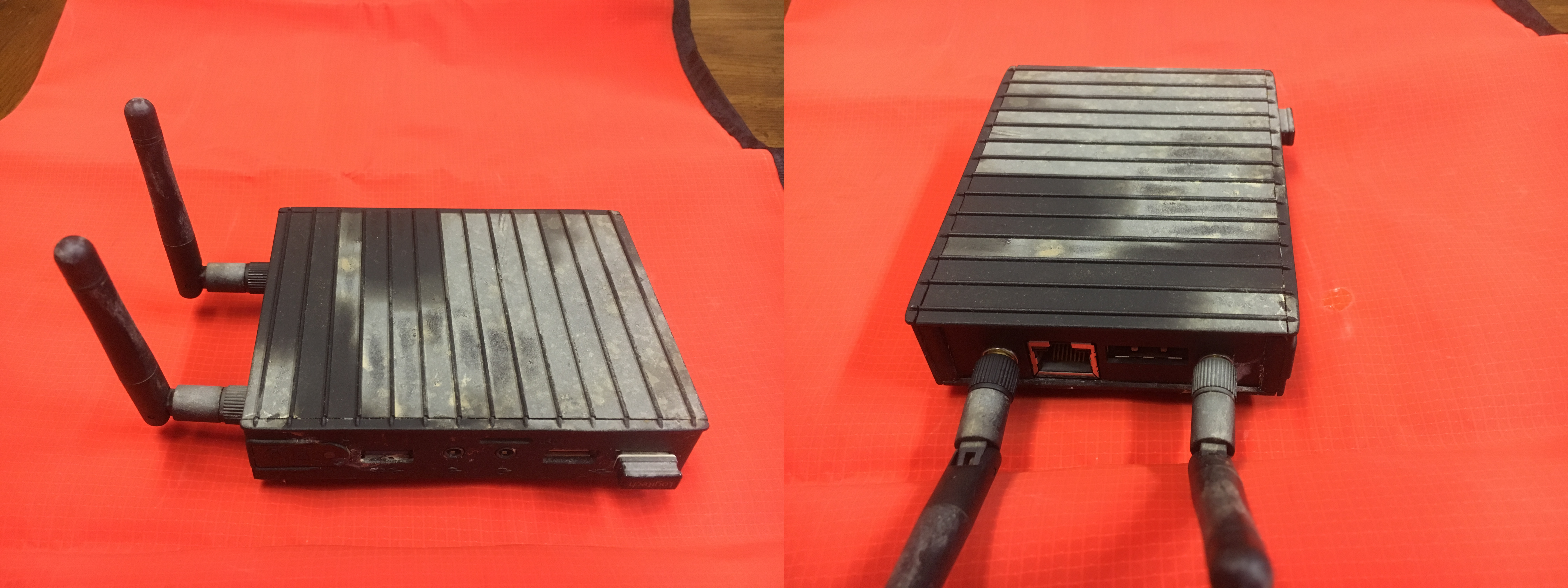

Fitlet - As Recovered - It Doesn't Look Good
Fitlet Disassembled Prior To Cleaning - Grime and Corrosion

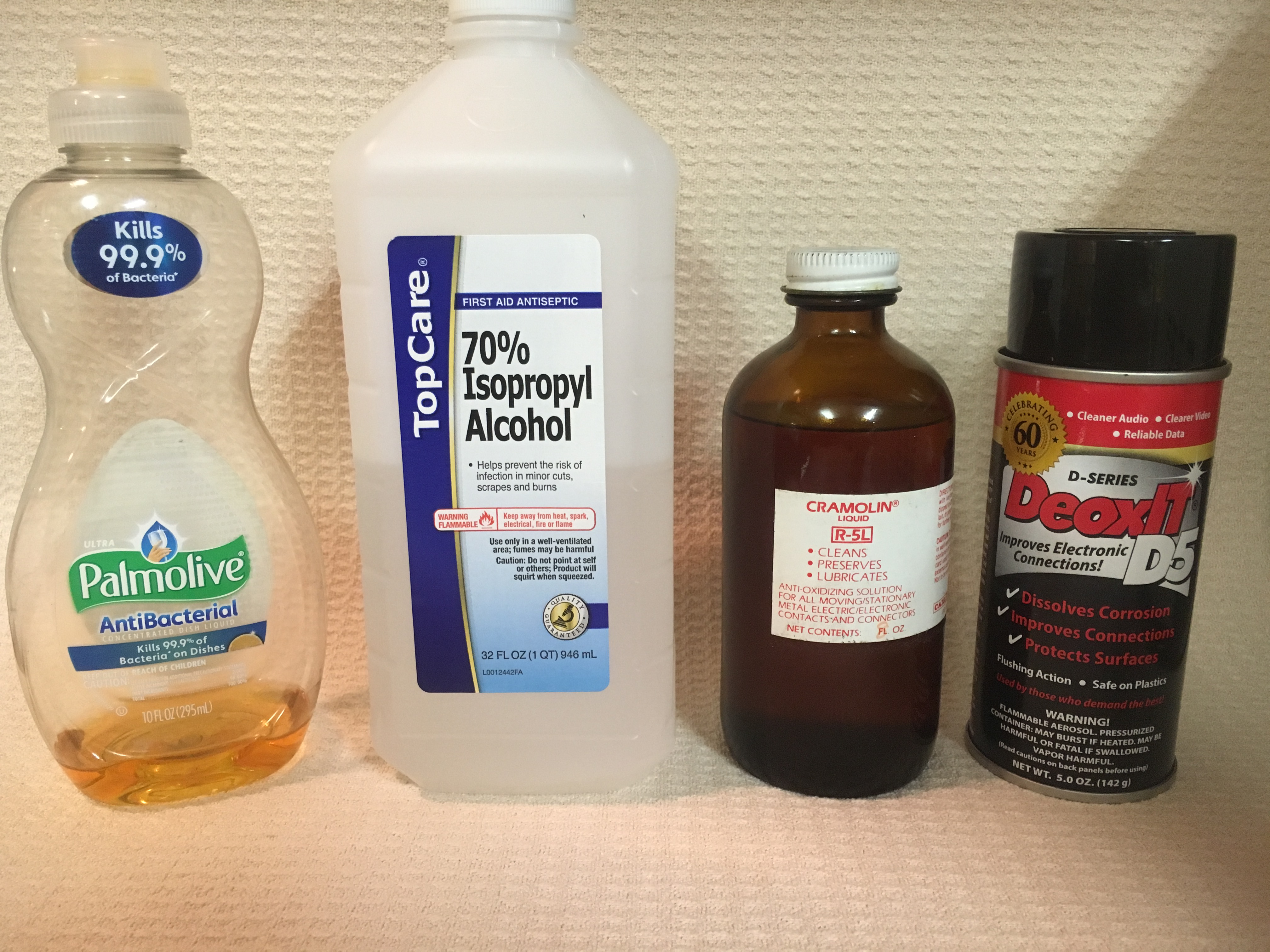

The Cleaning Process
1. Dishwashing Detergent - Clean/wash case components
2. Isopropyl Alcohol - Clean/flush circuit boards
3. Caig Laboratories Cramolin R-5L - Clean and remove oxidation from connectors, controls, and circuit board solder pads
4. Caig Laboratories DeoxIT D5 - Clean, remove oxidation from, and protect controls and connectors.
Fitlet After Cleaning and Drying - It Almost Looks New
Fitlet - Back In Operation - Amazing!!!
