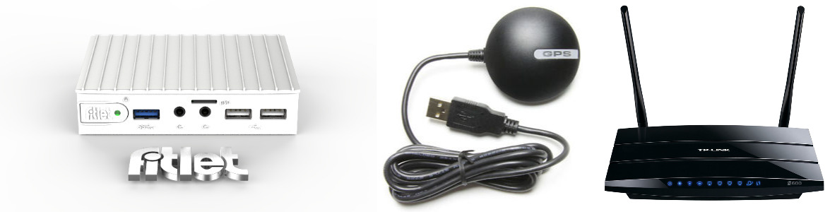

The hardware required for this application is as follows:
1. fitlet
2. GPS Receiver - USB type (I am using GlobalSat BU-353)
3. Network Router

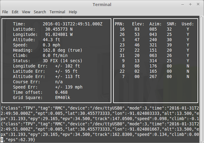

C. Verify the correct operation of the GPS and GPSD by running the command CGPS. Pay special attention to the parameter Time Offset. It is typically less than 1. If it is a huge number, there is a problem.

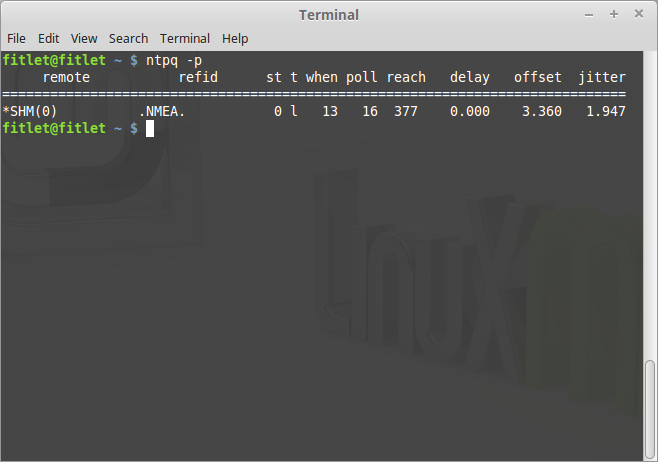

D. If cgps returns active, normal output then verify the correct operation of ntp using the command ntpq -p
You should get a listing similar to:
NTPQ -P.png (46.44 KiB) Viewed 16018 times

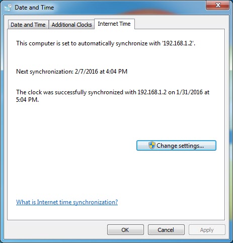

The image shown below is an example of my Windows 7 fitPC3 using Fitlet as a NTP server where the only NTP time source available is the GPS connected to Fitlet.
