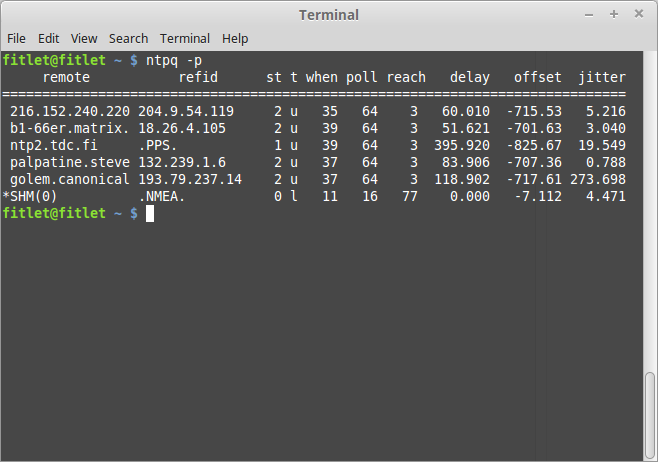

8. If cgps returns active, normal output then querry ntp using the command ntpq -p
You should get a listing similar to:
The above screenshot shows all of the time sources available to fitlet at the time of the query. The line
SHM(0) .NMEA. 0 l 11 16 77 0.000 -7.112 4.471
indicates the GPS receiver is providing time data to the NTP dameon.

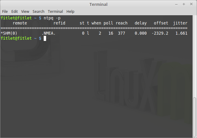

The following screenshot shows the time sources available when fitlet is not connected to a network and is also not connected to a GPS receiver. Even thought the GPS source is listed, no data is available due to the absence of a GPS receiver- all values are 0. This means that fitlet's system clock runs free and is not corrected by an external source. Over time, the internal clock will drift.
With a GPS Time Source
The following screenshot shows the time sources available when fitlet is not connected to a network, but is connected to a GPS receiver. The single GPS time source is listed and is supplying data. In this case, fitlet's internal clock is corrected to GPS time on a repetitive basis. System clock drift is eliminated.

Without a GPS Time Source
