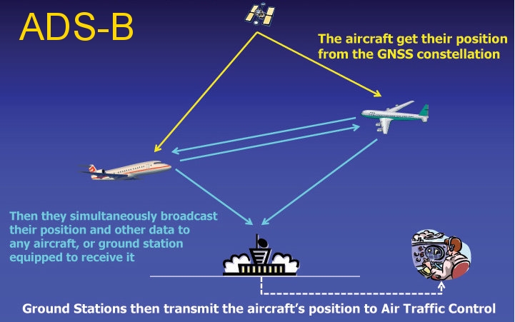

The acronym ADSB stands for Automatic Dependence Surveillance Broadcast. Airborne ADSB systems operate by determining the aircraft's position using Global Navigation Satellite Systems (Galileo, GLONASS,GPS, etc.) and then broadcasting data including items such as position, speed, heading, altitude, flight number, etc. Recipients of ADSB data include ground stations and other aircraft.
ADSB data links operate at either 978 MHz or more commonly at 1090 MHz. We will concentrate on the 1090 MHz broadcasts.

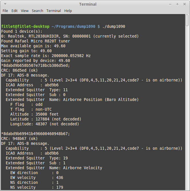

To use dump1090, issue the following commands in the terminal:
For interactive mode, use the command ./dump1090 --interactive

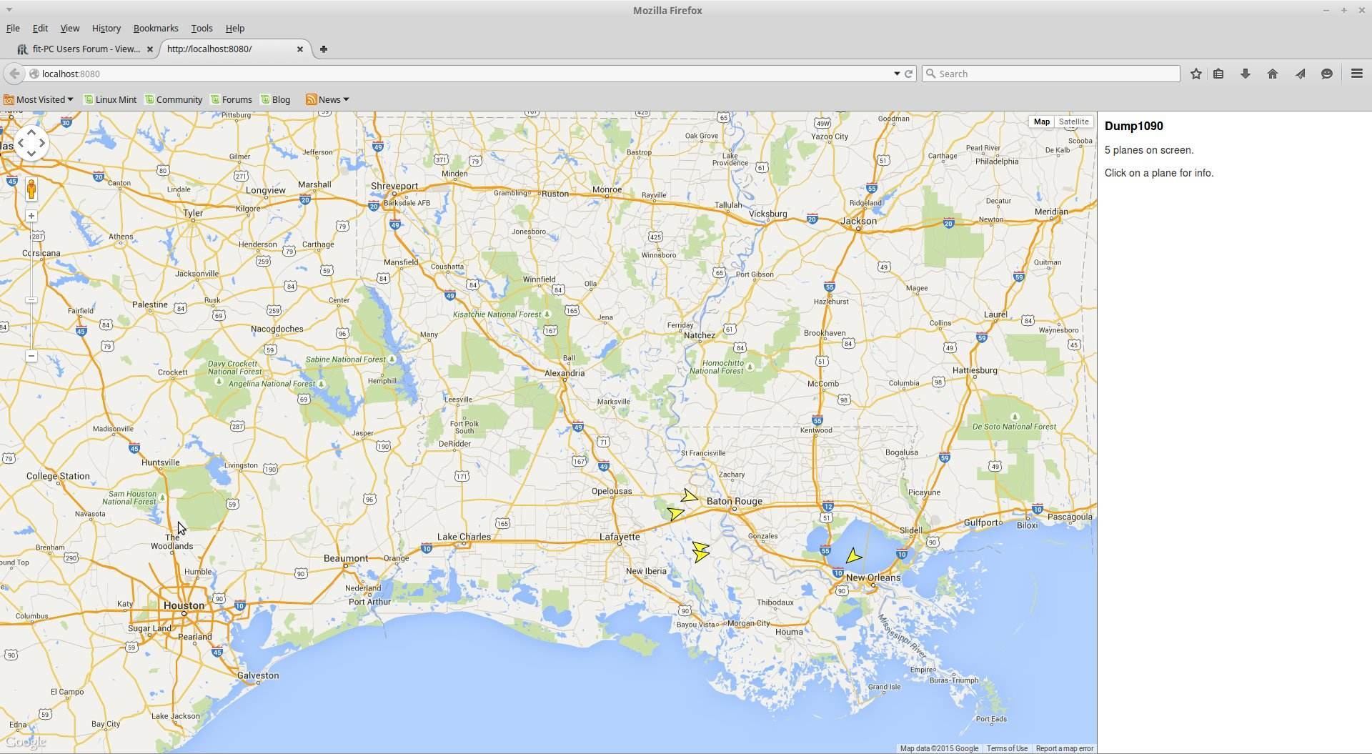

For interactive mode which hosts a real time tracking map, use the command ./dump1090 --interactive --net
Then open a browser and navigate to localhost:8080
You should see a real time map showing all aircraft that dump1090 is tracking.
This view shows 5 aircraft - each represented by a yellow arrow.

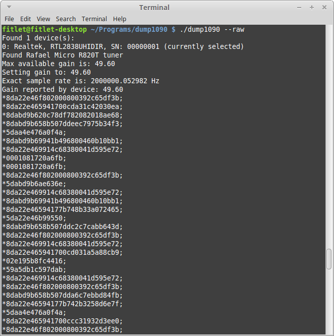

For unprocessed streaming data, use the command ./dump1090
For hexidecimal streaming data, use the command ./dump1090 --raw
