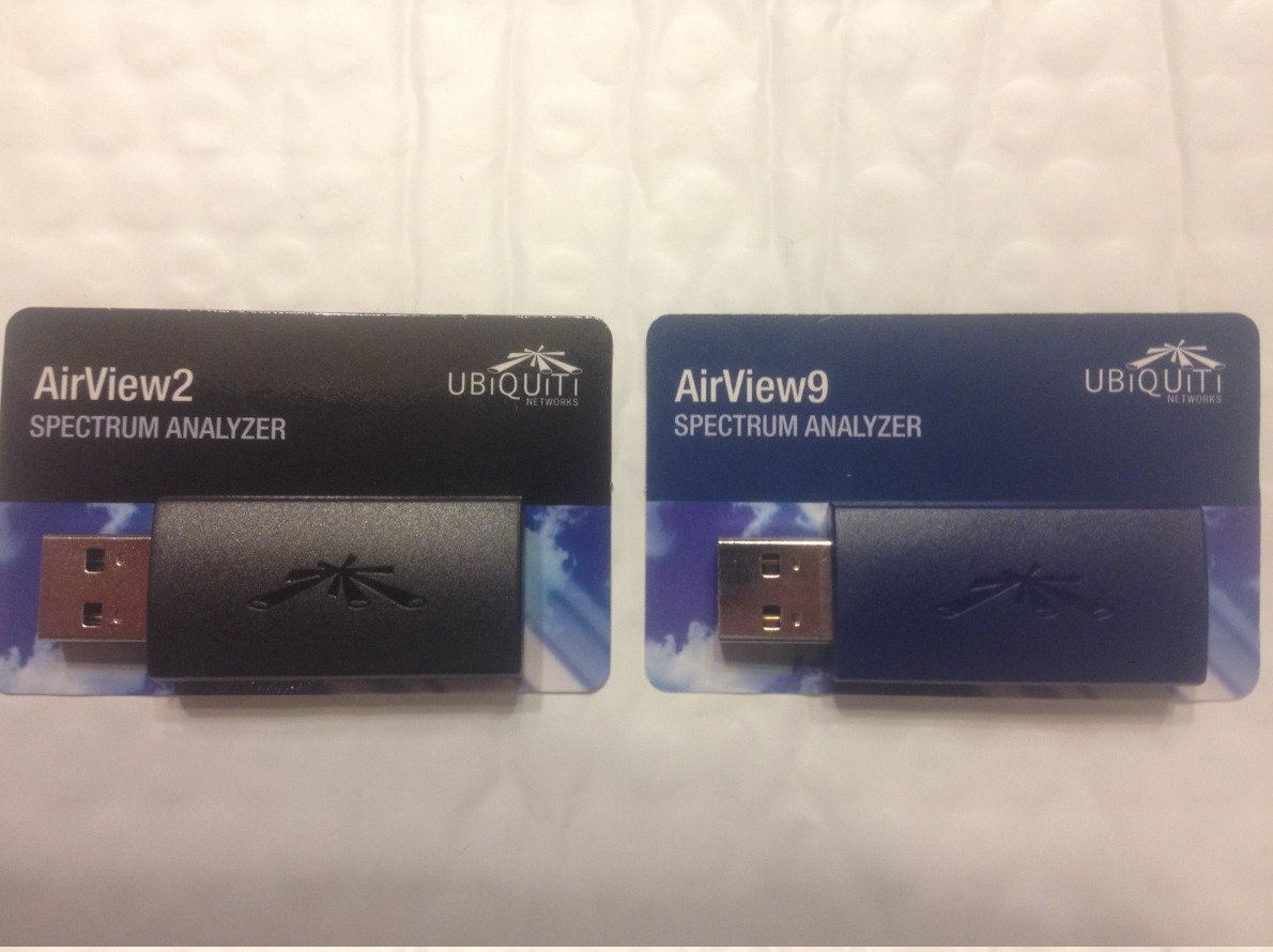

1. Fitlet
2. Ubiquiti Airview9 900 MHz USB Dongle
3. Ubiquitu Airview2 2400 MHz USB Dongle
Airview Hardware.jpg (150.65 KiB) Viewed 13247 times

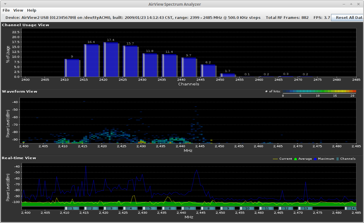

Results using the Ubiquity 900 MHz Airview9 USB Dongle
Results using the Ubiquity 2400 MHz Airview2 USB Dongle
1. The Airview Spectrum Analyzer hardware and software work quite well with Fitlet.
2. The scan rate of the Airview solution is quite fast.
3. Fitlet again shows its versatility by doing what I need it to do.
