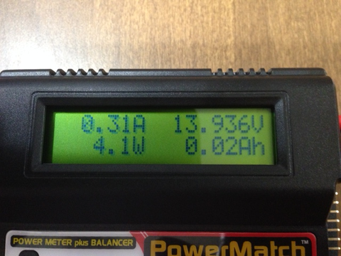

Here is an example of my Fitlet iA10's power requirement at idle for the following conditions.
Operating System: Linux Mint v17.1 Rebecca
BIOS TDP: 4.5 Watts
USB Peripherals: Wireles keyboard/mouse adapter + USB powered speakers
SSD ALPM Setting: min_power
WiFi: Active
Bluetooth: Active
HDMI Monitor: Active
