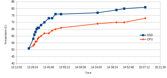

BergRD
Posts: 6
Joined: Tue Jun 23, 2015 9:02 am
Re: over 70 °C
Post by BergRD »
Thanks for the quick reply.
I don't mind the 65C, only that it seems to reach that temperature when doing barely anything.
I've done a test for the past hour and a half without fan.
The fitlet was busy saving 50 MB of data to the internal SSD every 5s, and additionally appending a string to a text file every 5s.
The fitlet will be used to control and save data from sensors, so this is ultimately what I want to do with it, but with more data (more sensors).
The test was done indoors at approx 25 degress with a light breeze from outside. In production I will want to put the PC in a box with barely any airflow.
Test results are in the attachment. I used HWMonitor to log the temperatures.
SDD and CPU temperature
