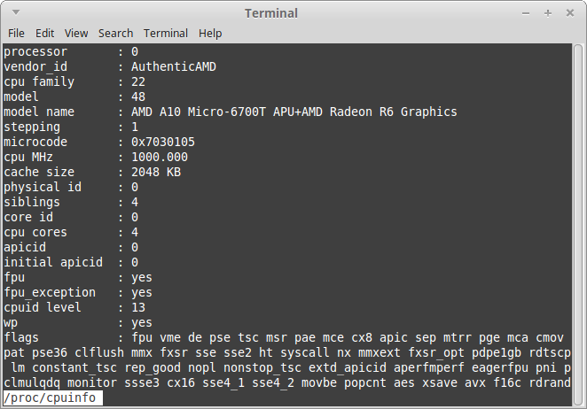

Oops. I forgot to mention that the label for my unit has a typo. It lists the processor as being an A4 Micro - 6700T - which to my knowledge doesn't exist.
Actually, my Fitlet is an iA10 variant and has the higher performing A10 Micro - 6700T.
