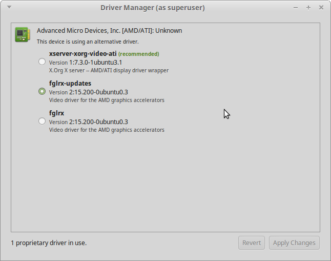

idtent,
I also had same experience.
I went into the Driver Manager and changed to 'fglrx'
I have read on the forums about an issue with fglrx 15.200 and blacklisting it in update manager or such but it seems to be working ok atm.
Brad
- Screenshot-Driver Manager.png (41.51 KiB) Viewed 11498 times
