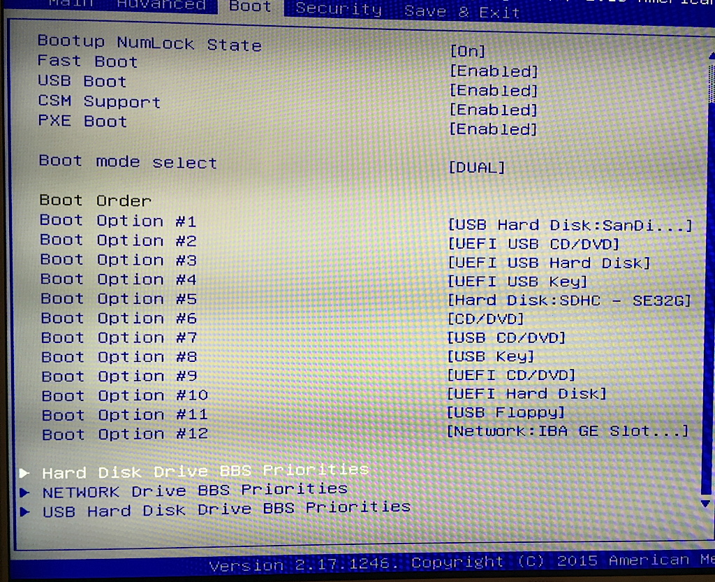

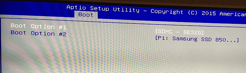

Great, played with boot options (Dual, Legacy, UEFI) and then found, that one must scroll all down the the end of the screen to find the hard disk options/priorities.
Have to try tomorrow, if this works as intended and the removal of the SD card leads to boot from internal SSD.
Hard disk priorities

Scroll *all* down to find options
