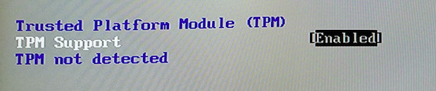

I have a new IPC2 and wanted to use the TPM capability - per the block diagram, there is an Atmel TPM:
http://www.fit-pc.com/download/intense- ... iagram.pdf
However, in the BIOS, it says TPM Not Detected. Do I need to do something to enable it?

- Screen Shot 2017-08-13 at 8.58.24 AM.png (185.77 KiB) Viewed 10199 times
Re: IPC2 TPM Module
TPM is a optional chip that is not mounted by default. It should be stated while placing an order. We can provide such a service via RMA, but it will add $200 per TPM and shipping cost.
