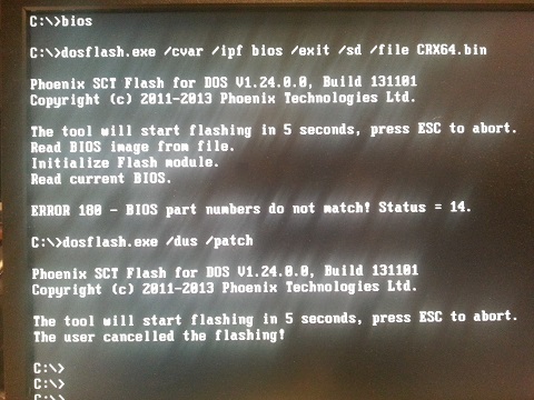

Good day,
I'm trying to update my µSVR servers from CR_2.2.2.0.346 X64 to CR_2.2.2.0.400 X64 and I'm experiencing this error:
Error 180 - BIOS par numbers do not match! Status = 14
The BIOS was downloaded from here:
http://fit-pc.com/download/intense-pc/b ... 2-2013.zip
I believe that I have followed all steps correctly and that the BIOS is the correct version please help.
Thank you

Thank you,
I download and created an USB key with the new one, the flash went ok but now the server goes down 2 seconds after powering it on...
If there is now way to recover I guess it is dead...
bad move...
Paulo
mbirger
Re: µSVR BIOS Upgrade
Please try to reset the BIOS, by shorting two TPs under one of the SO-DIMM slots. I doubt if it will help in your case, but lets try.
If it won't help, please consider an RMA. We will check the files once again.
