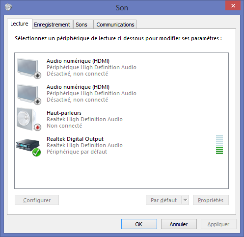

No, there is no registry patches.
You should see something like this on your playback devices tab
Dou you have other HDMI device for testing purposes?

I have the same problem. No sound on analog output (I can't test with digital). But it's like it has not detected that I pluged the speakers.

That doesn't work.
I also tried with an HDMI device and I get the same result
Julien
