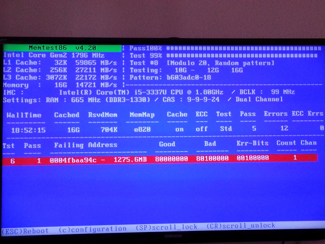

I had errors on memtest with the first set and then the second set that I RMA'd with Corsair. I have uploaded a photo of the memtest with errors. The issue definitely seems to be something to do with the Mintbox 2, the same issue as described by supz. It seems that there is something picky about the Mintbox 2 with respect to memory. This is something, however, that is not part of the spec.

- memtest with errors
- IMG_20140226_145147_1_small.jpg (335.19 KiB) Viewed 18383 times

As mbirger states CompuLab is unaware of any incompatibilities with the IPC and memory. However community testing has shown that this is not the case, the IPC is incredibly picky about memory.
I went through the same experience until I purchased a kit that was certified to work by CompuLab. My experience with memory incompatibility is here: http://www.fit-pc.com/forum/viewtopic.php?f=95&t=5216
@blackbox: I RMA'd my first unit to CompuLab. The replacement unit had the same incompatibility. You will not get your memory to work. I would suggest selling it to someone with a less picky computer and purchasing a kit listed by mbirger as compatible.
I purchased the Crucial CT102464BF1339 from Amazon and it works as expected.

After an RMA, Fit PC now has my Mintbox 2 and the non-functioning 16gb of Corsair RAM for testing in their lab. That RAM, btw, was purchased from Amazon where I also bought my Mintbox 2.
They were really good sports about it. They sent me back a Mintbox 2 with 16gb of functioning Crucial RAM.
Although this is just speculation, judging from the post by mbirger, it seems like maybe the picky RAM issue doesn't affect all Mintbox 2 devices.
