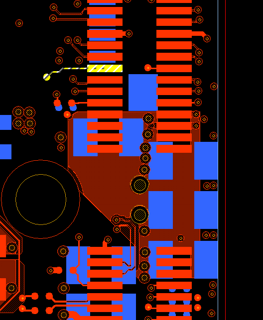

SLP_S3# is the signal indicating entering S3 (sleep) state in fit-PC3, where most of system functionality disabled.
It can be sampled on Extension connector P10 pin B43. See file attached.
- fit-PC3_P10.B43_SLP_S3n.PNG (31.1 KiB) Viewed 12239 times
