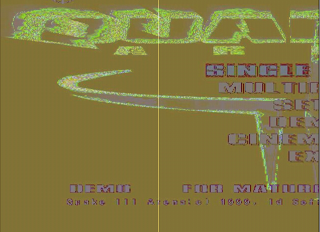

Re: Random system reboot
I did what you told to do in your last post,
no crash since then, but it a bit of speed has been lost.
it's interesting since it seems to affect openGL stuffes
(softs which I try to test)
as an exemple I'll show you a quake 3 screenshot:
Thanks I think it will no crash anymore.
- Quake III_demo_fitpc2_ie10.3gold_bios_cpuhyperthreads_off.jpg (220.58 KiB) Viewed 16305 times
